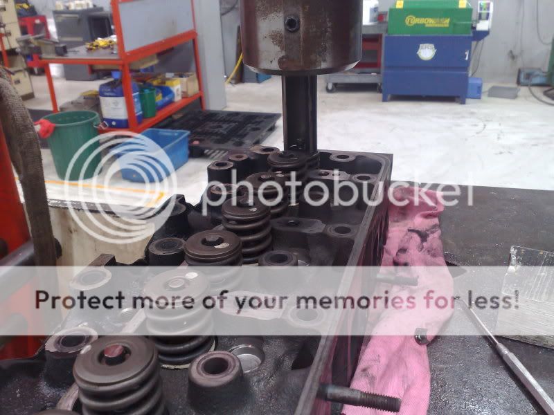

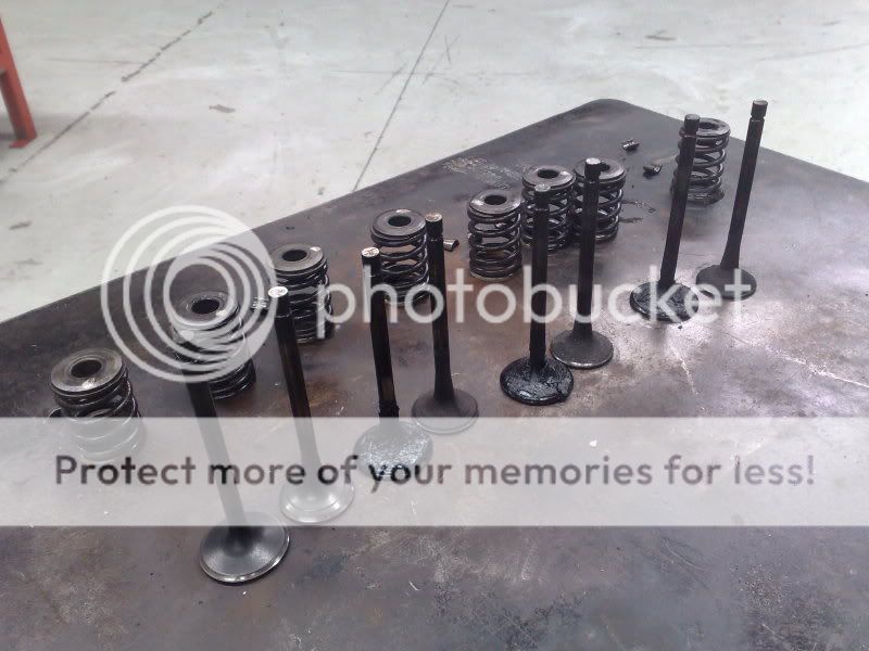

Did up the head this weekend, all this has been very time consuming.
Very clagged up

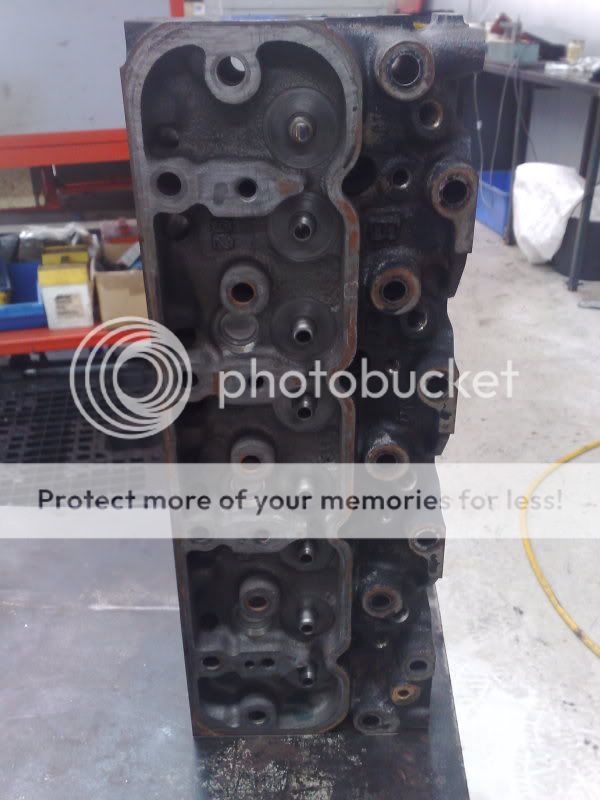

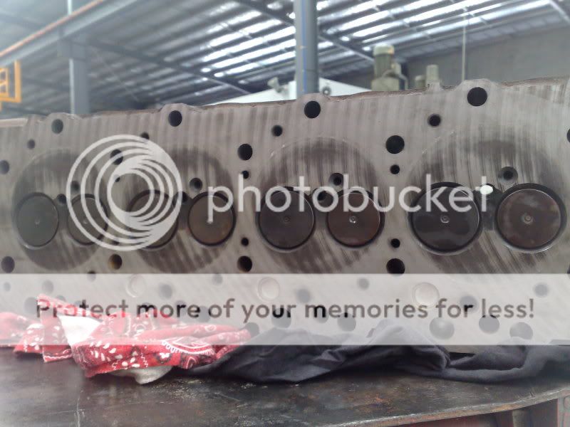

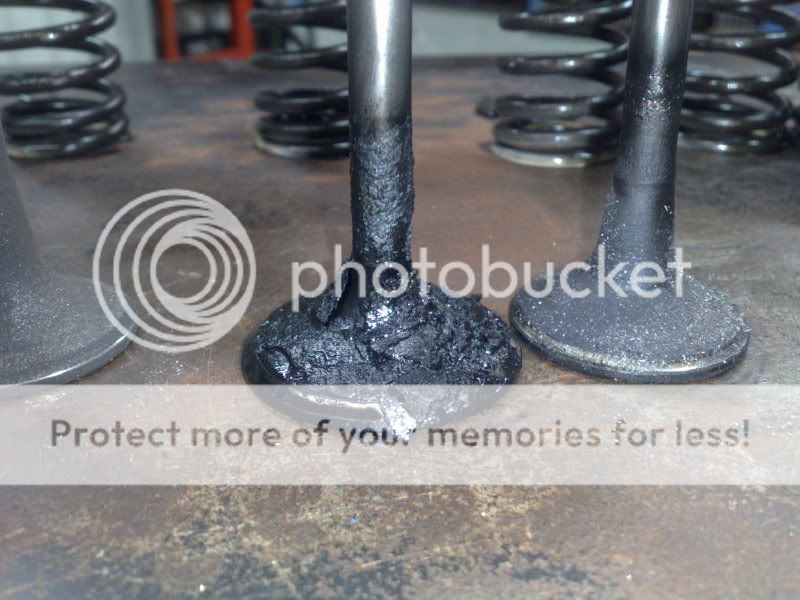

Found two of the inlet valves were bent.

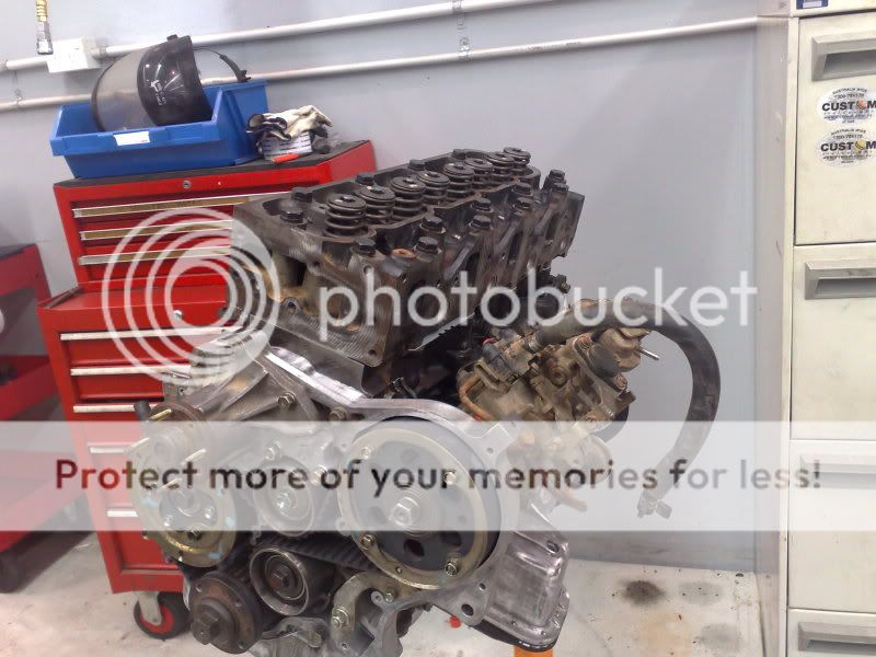

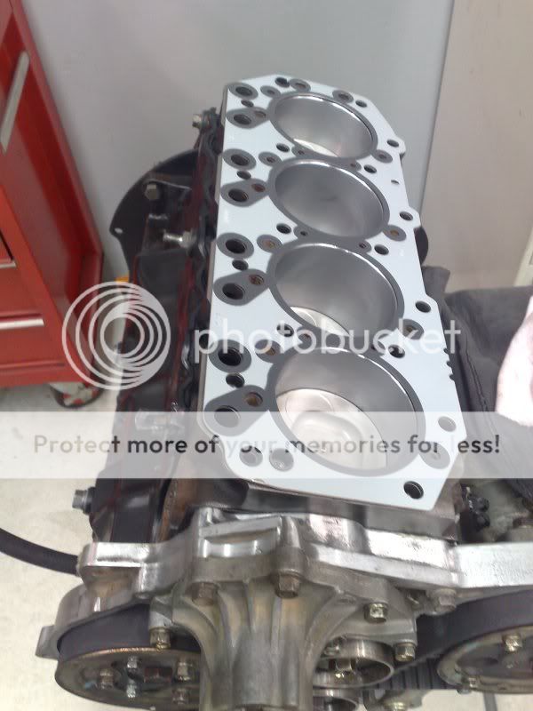

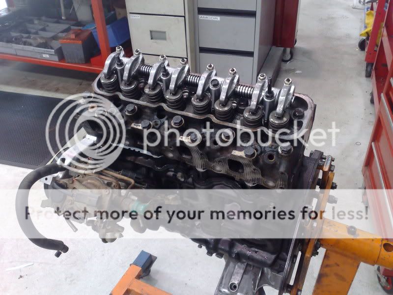

Grade 3 head gasket
tensioned
rocker gear and push rods in

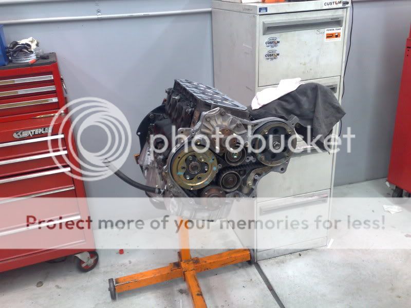

The intake plenum on this was heavily caked with oil gum, this was from the blown engine which would have been in good condition before it went for a swim, the valves were in the same engine... I tried everything to get it out, degreaser, burning, turps, and hot wash for hours.
Belt that was supplied with kit.
More next weekend.................

Triclorethylene or carbon tetrocloride would of got it but its hard to get these days. Something about eating ozone
